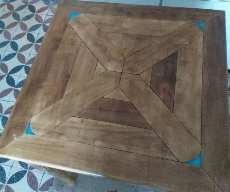

I didnt have a board big enough, so I had to mosaic it together.
I bought 5 pieces of 80X40X1,8 cm wood pieces.
And start scatching again :)
You can see, that I needed to put 5 piece of components from the 5 block of wood, by cut out 9 pieces: measurements on the papers: which are already precise units, after a dry fit:
a base part: could only make out of three parts.
the top to lift
a small top
and two aprons, that I originally planned to cut from a piece of lath, but miscalculated, and didnt have a lath long enough; but fortunately had enough of the big pieces, that I could cut, and glue together.:)
Ane here comes to advantge of having a table saw. I had to file, and plane a lot to have (almost) straight and matching edges. Seriously: next time I would take those pieces to a place, where this is available.
