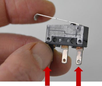

Step 2: Find and Characterize a Lever Micro-switch
I found a lever micro-switch in an old printer (see step 5), that I take apart with Nir.
I wanted the light to be ON when the box lid will be open, i.e, when the lever arm is up, so I tested the wiring with a multimeter.
I realized that the UP position of the lever will refer to the ON state of the switch, if I connect the LED through the two contacts at the ends.
I straightened the end of the lever with pliers, so that it could be between the box and the lid, without interfering with the closing.
