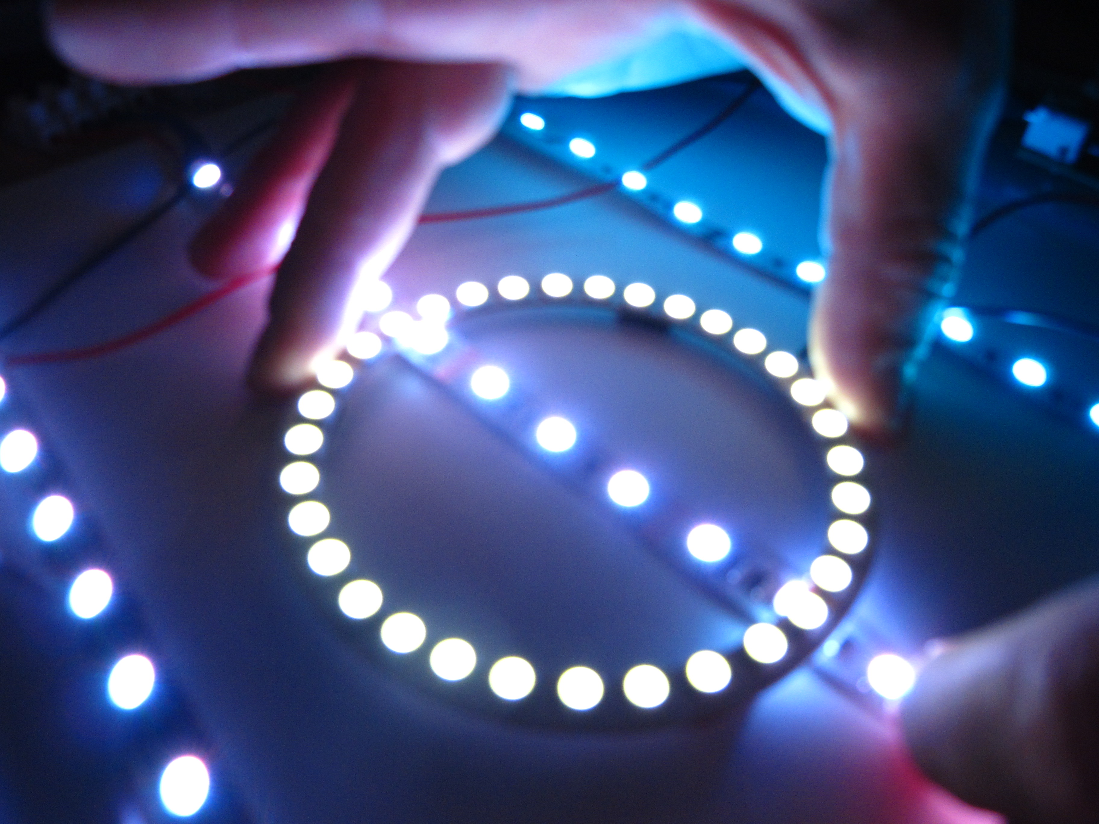

Step 3: LEDs
Once all the controllers are out of their cases, its time to test and connect the LEDs.
Repeat 3x:
Cut off a 15 LED strip from the 90cm roll you bought.
Test if all the colours work by using a power supply, and working your way through the 4 connections.
You should see these colours:
- Red
- Green
- Blue
- White
Then test the controller.
Do this by connecting it using the adapter, and connect the LEDs using crocodile wires.
Again, test all the colours using the IR remote.
Once you have worked out which connection works with which colour, solder the connections, best with a little bit of extra wire in case you need the connections to be longer.
You need to experiment what connection controls which colour as this depends on the controller you use, but it is usually clearly explained in the instruction manual which comes with the controller.
Finish off by putting a shrinking tube over the solder connections to make the whole thing neater and prohibit any short circuiting to occur.

Step 4: Amplifier, Speaker and Sound Detector
Now its time to test the speaker, amplifier and sound sensor.
All these circuit boards should already be out of their cases.
First, connect the speaker to the amp if has not been done so already.
Add power the the whole thing by connecting it to it's adapter.
Connect an iPod or CD player and play some music to see if the whole thing works.
After this, connect the white LED ring to the sound detector and connect the whole thing to power.
Play some music, which should then be picked up by the sound detector's microphone, and then make the LED ring flash accordingly to the music. (Its best to use a music with a lot of beat or drums)
You can then adjust the sensitivity of the sound detector using the RF remote control (If included)
Once everything works, connect the wires, but DO NOT SOLDER THEM. This will be done later on.

Its time to stick everything down. Use the sketch on "the actual thing" to position everything, using rulers and protractors to make sure the angles and spaces are correct.
The LED strips tend to have double sided tape on them so just use that.
When sticking the LED ring, use the spongy heavy duty tape (layer it if you have to) to get this LED ring lifted above the others. Again make sure it is positioned right in the middle.
After that, stick all the circuit boards down. Stick them using the heavy duty tape so they hold strongly but are also cushioned and protected. Make sure, the cables that are supposed to be lead behind, are.
You may have to cut the wire in half, put it through the hole and then solder it together again, but remember, but a shrinking tube on it to avoid short circuiting anything.
Then connect the wires to the board. DO NOT STAPLE THEM!! This cracks the acrylic glass and breaks the wires. Inside the box, you can use a hot glue gun, or use this method.
Drill a hole through the board. Put a loop of wire around the cable, and put the loop through the hole. On the other side, put a piece of plastic or wood between the two ends of the cables and twirl it before finally hot glue gunning it. You can also just split the ends to both sides and staple them.
I would recommend this method when connecting the wires at the top or bottom on the acrylic glass where it can be seen.
connect all the wires nicely.
After this, take some more of the sticky plastic, and stick this over the wires in the box itself, so no shapes or dark reflections will be seen later.
