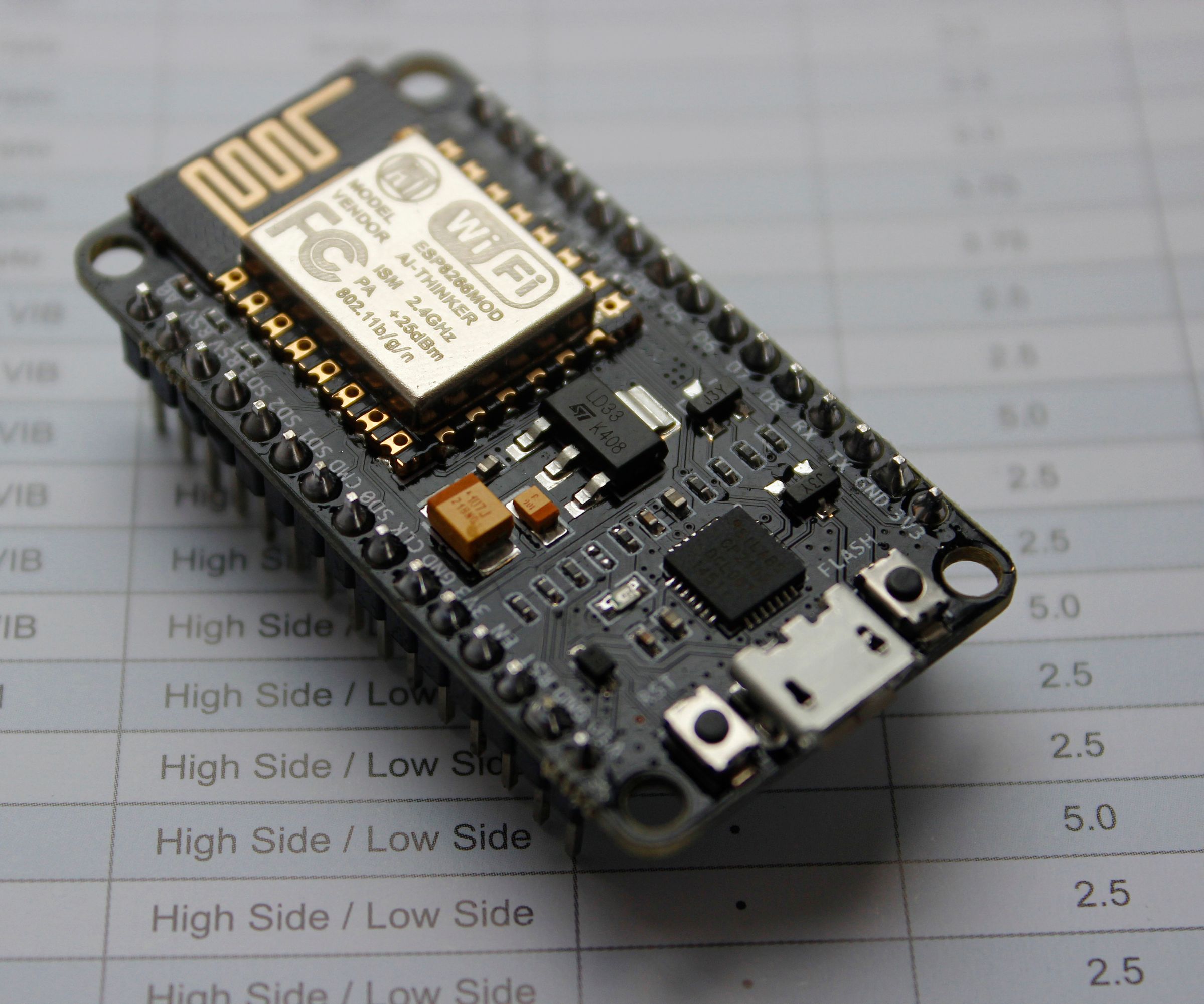

- 1x ESP8266

The connection to the relay is very easy you only have to connect GPIO 13 from the ESP8266 to the base of the transistor with the 100 ohms resistor the collector to one part of the relay and the emitter to ground with the 470 ohms resistor we use the transistor because the current provided by the esp8266 isn't sufficient.

La conexión al relevador es muy sencilla solo tienes que conectar el GPIO 13 del ESP8266 a la base del transistor con la resistencia de 100 ohms, el relevadoral colector y el emisor a tierra por medio de la resistencia de 470 Ohms

First of all you'll need to have the ESP8266 library and module installed in the Arduino IDE if you dont have it you can follow this instructable
"https://www.instructables.com/id/Programming-the-ES...
Now if you have all installed is time to program your ESP8266 this program made by me works in all version of the ESP8266 even in the ESP-01, if you use this you will need to change only the GPIO used in the program, this program creates a webpage on its IP where you can acces and it will ask you for an user and a password, before defined in the program, once verified your user you will enter to a very simple interface with only one button to toggle the state of the light.

Once you have done all your connections and programming is time to test so, open your favorite browser and your Serial monitor and restart your ESP8266 it will connect to your WiFi and it show you its IP which you'll need to access, once accessed put your user and password in order to proceed to the principal page and get access to our button to toggle our light
