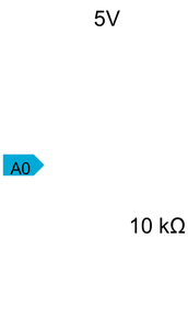

Step 2: Connect the Photoresistor
Now, add your photoresistor to the circuit. Connect one end to the positive rail of your breadboard, and the other end to analog pin 0 and a 10 kΩ resistor. Then connect the other end of the resistor into the negative rail, as show in the second photo.

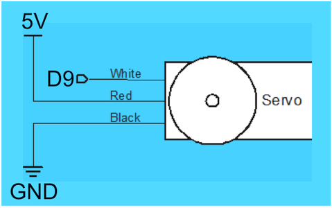

Step 4: Connect the Servo
Now that we have the LEDs working, add the servo to your circuit. Connect the white wire to digital pin 9, the red wire to the positive rail (5V), and the black wire to the negative rail (GND). Your completed circuit should look something like the third photo.

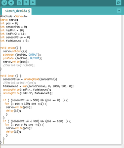

Step 5: Program the Servo to Turn at a Certain Brightness
Add the following bolded lines to your code:

This will be used to lower a shade if the brightness sensed by the photoresistor is greater than 500 and raise the shade if it is less than 400.

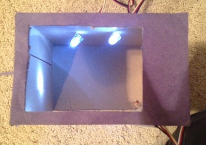

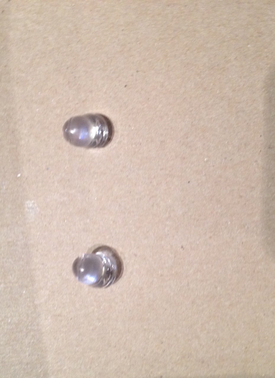

Step 6: Set Up the LEDs and Photoresistor in the Box
Find a small box and cut a hole in one side to represent a window. Then poke two pairs of small holes in the top of the box. Put the LEDs through the holes and put the photoresistor in a bottom corner of the "window." Connect them back to the breadboard using servo cables.
