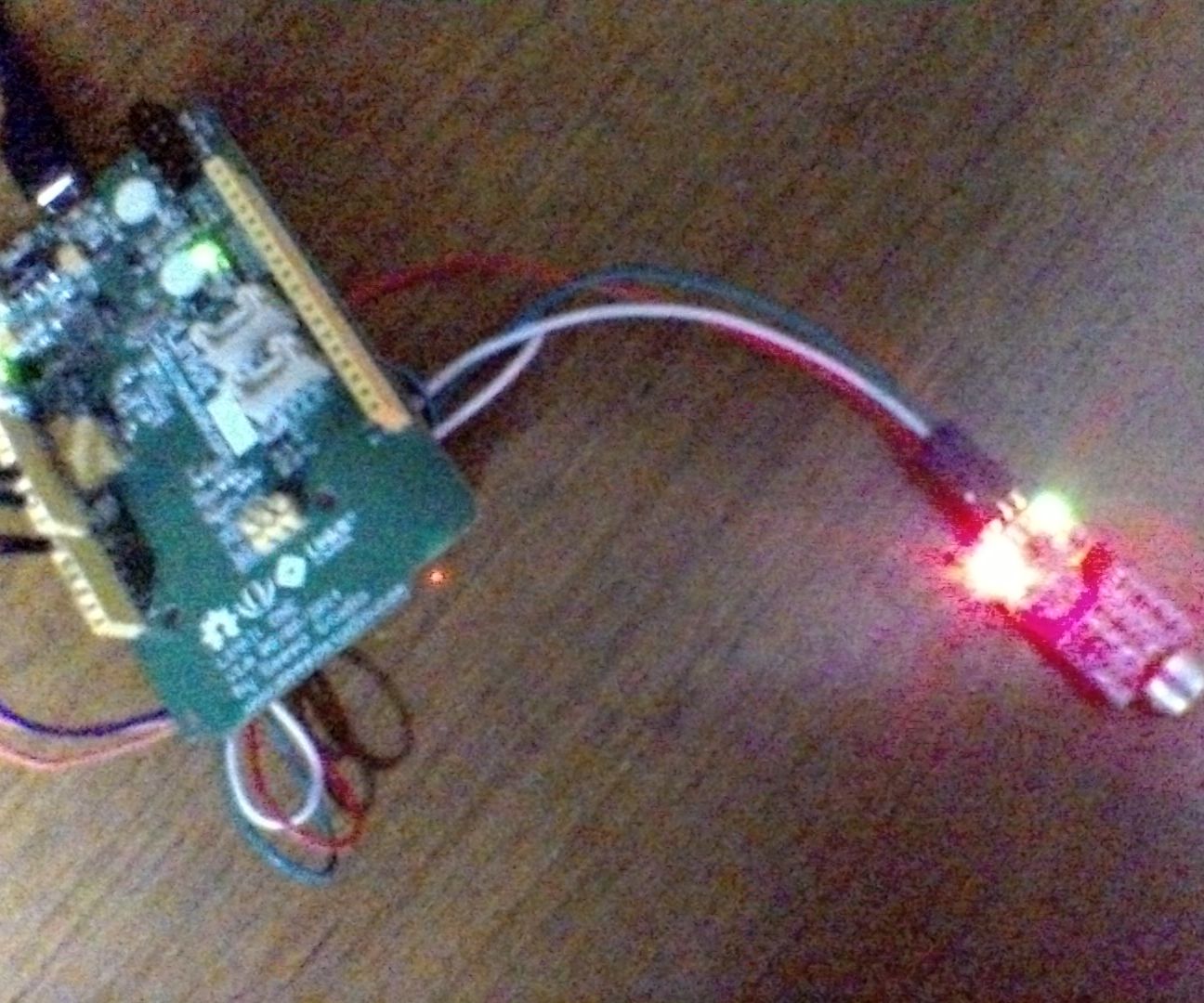

Step 2: Attach Servo Motor
Now we will build the servo motor. After that we will attach it.
We will using PIN 9 to attach the servo.
Step 3: Connect Light Sensor
Connect your LDR. Connect it into A0 pin and ground pin one.
Step 4: Connect USB
Now connect your USB cable with laptop and board so we can power the board.
Step 5: Write Code
Burn this code to your board.
#include'servo.h'
Servo myservo;
int val;
void setup() { myservo.attach(9);
void loop() {
val = analogRead(A0);
val = map(val, 0, 1023, 0, 179);
myservo.write(val);
delay(15);
Step 6: Test the Servo
Now test your servo!
more light, more speed!
