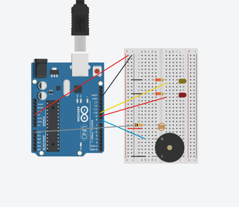

Step 1: Breadboard Prototype
This is a prototype version of the project, it works exactly the same as the permanent version but it's a little bit less structually stabile.
Start by copying the layout of the breadboard from the first image seen above.
Once you've copied the layout it should look something like the second image. Next you have to plug plug your arduino into your computer and copy this bit of code into the arduino IDE and upload it to your arduino.

If everything is connected properly on your bread board your prototype should behave like mine does in the youtube video. The photoresistor detects the amount of light in the room and causes the lights and buzzer to flicker and beep accordingly. With low light only the first LED will flicker, it will flicker slowly and the buzzer also beeps slowly. Medium light causes both lights to flicker more frequently and the buzzer beeps quicker as well. With a lot of light both lights will flicker super fast and the buzzer will be constantly beeping. You can test the diffirent stages by holding a finger over the photoresistor or by shining a bright light into it.
