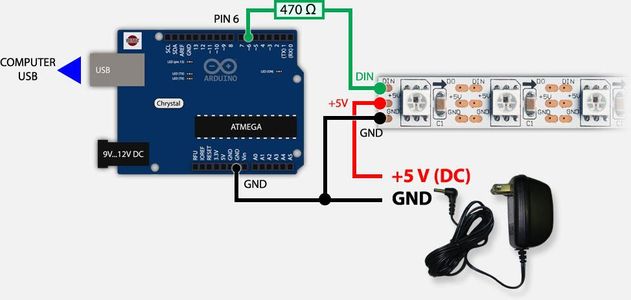

Step 1: LED Connection
cut wires of different colors to solder them between each LED
I prepared 16 batches of 4 LEDs linked together

Step 3: Programming and Testing
the 8 junction boxes are used to connect the 2 headlights with the cables that will connect the cars to each other.
I could unplug the cars at any time to move them in case!
for the tests, I fixed the bulbs on a broomstick for the time of the programming and the tests
