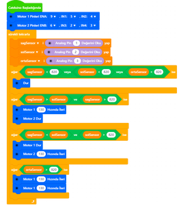

Step 9: Code Uploading
upload code to Catduino from mBlock. if you want, you can write this code in Arduino IDE with C.
