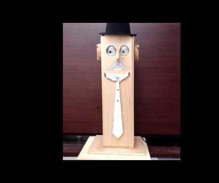

If somebody wonders whether robotics can come along with an empty pocket, maybe this instructable can give an answer. Recycled stepper motors from an old printer, used ping pong balls, candles, used balsa, wire from an old hanger, used enameled wire were some of the materials I have used to make this robotic head. I have also used four servo motors, one adafruit motor shield and an arduino UNO. All these were reused from other projects, which they were savaged! All makers know that this is unavoidable in order to save money.
Since there is no robot without interaction with the environement, this one tends to turn towards and look to the brightest spot around. This is made of the cheapest sensors ever: the photocells. They are not the most trustworthy but are trustworthy enough to make something decent.

There some obvious inaccuracies but considering the extremely low cost and the "soft" materials I've used the result seems satisfactory to me!
At the photo it can be seen that the servo that turns the eyelids actually makes the move to one direction and leaves the work to a spring for the other!
