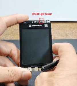

I immediately asked for information because I have no experience with this development board so far. In fact, the device is based on an ESP32-S3 Xtensa LX7 microcontroller and an ILI9341 TFT display with a resolution of 320x240 pixels. The display is protected by a metal frame and right above it are a light sensor, a temperature and humidity sensor, as well as two microphones for noise reduction. There are two buttons on the side and an edge connector at the bottom for connecting additional modules and sensors. On the back there is a camera, three I/O connectors, a micro SD slot, a speaker, three RGB LEDs, an accelerometer, and a battery interface.

After this, it was logical to try to activate some sensor from the board, and its values would be displayed on the Analog meter. I decided on the LTR303 light sensor located just above the display.
In this case, I use the Adafruit library designed for this type of sensor. I took most of the program from the example in the library and it concerns drawing and moving the needle of the analog meter. The other part uses the Adafruit library to read the values ​​received by the sensor. To my surprise, this library also functions quite normally on the K10 development board.
