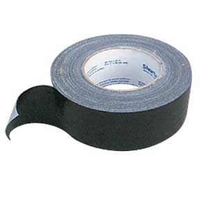

Step 1: Materials
Depending on what you are going to make, you will need the following:

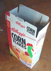

General: Scissors, tape( I used black, chrome, and white duct tape), cardboard(preferably thin cereal box kind), rubber bands
Stofen: frosted plastic bowl or tupperware type stuff, knife or something to cut it.
Grid spot: Black straws

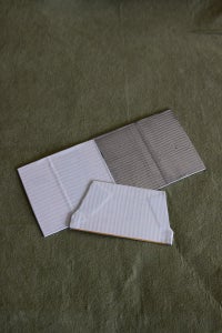

Step 2: Bounce Card/Gobo
I will start with this because it is the easiest. You can make this any size you wish.
First:
Lay your flash on the cardboard and mark the width(long side/top). cut a strip along this line. It should be a couple of inches wide. Most of mine are about 3" wide and 4-5" long. You should now have a rectangle piece of cardboard.
Next:
Use the duct tape to cover the surface of the cardboard. To make your card do double duty, cover each side with a different tape(ex:chrome on one side and white on the other).
To use:
Simply rubber band it to your flash. The side facing the flash will be what gets "bounced". Chrome will obviously reflect more. Use as a gobo to prevent lens flare.
First:
Next:
To use:

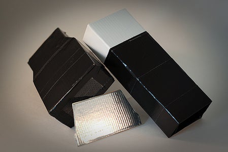

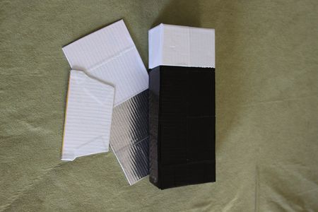

Step 3: Snoot
A snoot is also a really easy mod.
First:
Simply lay your flash on the cardboard and measure out...just as with the bounce card. This time, rotate your way around the flash.
Next:
Crease the cardboard at the lines you made when measuring the flash. This should make a cardboard tube when folded.
Then:
Tape the entire surface. I used white at one end and black at the other. The white will soften your spotlight, while black will harden it.
Next:
Fold and tape the seam where the two ends meet. That's all!
To Use:
just slip it onto the flash and if you need to, rubber band it on.
First:
Next:
Then:
Next:
To Use:

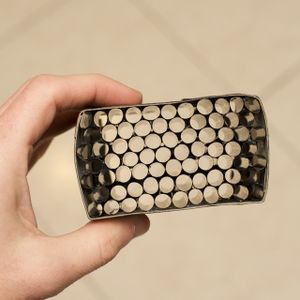

Step 4: Grid Spot
The grid spot is accomplished by making a honeycomb pattern out of the straws and then shooting light through it. The light bounces around inside and is forced to come out in a straight line.
I could go into details, but there are already several good tutorials out there. For mine, I used stir sticks instead of regular sized straws. I simply suck them in a snoot as seen in the previous step.This creates a very soft spot light, but eats up a lot of stops.
Here is a link to an instructable: https://www.instructables.com/id/Black-Straw-Snoot/

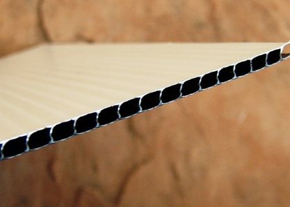

you can also make them by stacking and gluing coro-plast sheets together.
