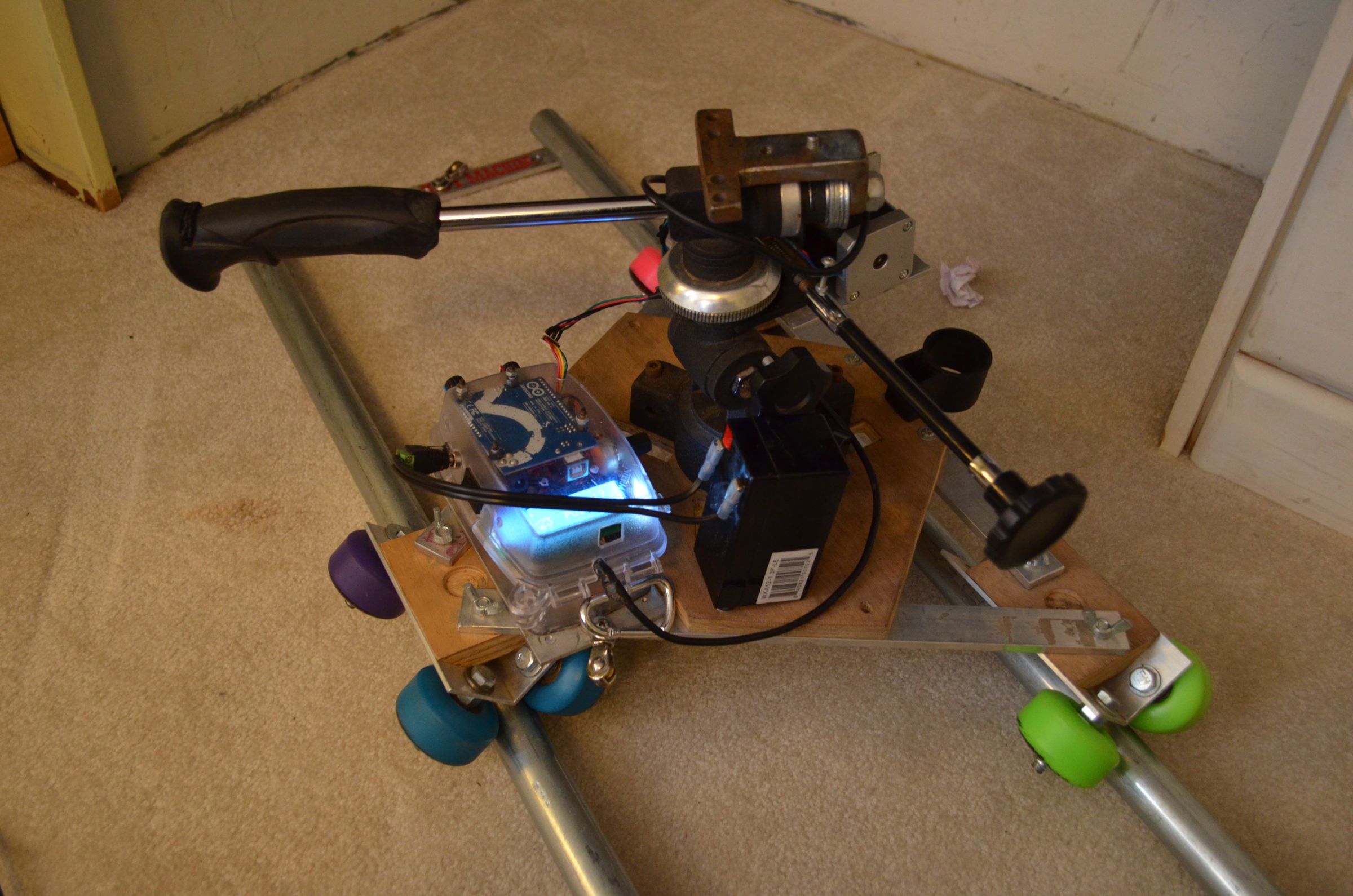

Whats next? I'm working on dynamic light painting with night time lapse's... I've got to slow the fade down a ton and build a whole bunch more box's. Maybe connect them on a Xbee network, take a hike around some natural features to place the box's, wait till night and let the lights shine!
