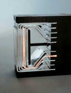

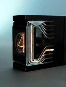

Several years ago I found four cute light pipe displays (aka edge-lit displays) with 20 mm high numerals for my vintage display collection. I got them from an ebay seller located in Poland. There is no manufacturer's label on them, unfortunately, but they look almost identical to the British-made KGM-M3 displays from which I was allowed to show you two internal views (see above).
Light-pipe displays date from about 1960, and I found an English patent specification for them (PDF attached below). The two smaller pictures above, courtesy of Udo Radtke, http://www.tubecollection.de/ura/lichtleiterdisplays.htm, illustrate the functional principle and are worth at least 1000 words each. These display units contain twelve small incandescent bulbs, also referred to as 'pea bulbs' - ten for the numerals 0 to 9, and two for the left- and right-hand decimal points.
The light emitted from the light bulb currently active is injected into the edge of a transparent, plastic light guide. Twelve of these guides are stacked behind each other. Little pits in the shape of numerals and decimal points are provided in each of the light guides. When the light from the pea bulb hits these pits it becomes scattered, and the numeral (4 in the example above) lights up when observed from the front. Thanks to total internal reflection within the light guides, almost no stray light can be seen except the one from the numeral currently illuminated.
