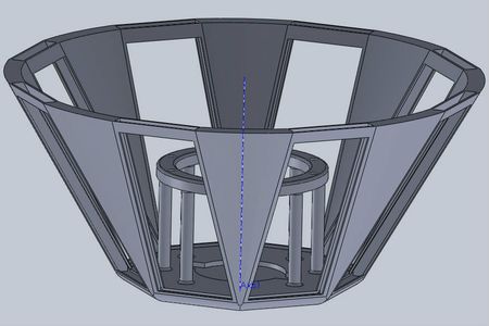

Based on the size of motor and how I was going to hang it, I had about 4 inches of vertical space. I also looked around for the largest diameter light bases in our house and they were around 9 inches. So. I decided to keep my design envelope at approximately 4 inches of height and 9 inches in diameter. I had the size of my mini solar panels and started to sketch out the design to see what would work. I worked out designs of 6, 8, and 10 mini solar panels, set at a 30 or 45 degree angle. The 8 panel set at 30 degrees fit my design envelope best. I also liked that the extra solar panels would give me a bit of margin for error.
I started designing the enclosure in 3D starting with the panel layout. I drew the bottom and top profiles, then lofted a solid shape between them. A shell was formed from this solid for form a wall of .300" thickness. A rectangles cut was extruded down at an angler from the top surface to hold the solar panel. Then a slightly smaller rectangular extrusion cut was made for the panel opening. Once this looked good, I patterned these two features to cut to the remaining 7 sides. For the motor inset, I took the motor dimensions, added ,005-.010" and extruded a cut into the base. Next, I added two features for securing the enclosure to the hook. This involved extruded 8 posts from the base up to the top of the motor. At the top of these posts is a ring with 8 holes for securing the hook assembly to. Finally, I rounded any edges the best I could, both for aesthetics and strength.
