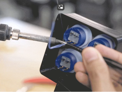

Step 2: Wiring Diagram
Step 3: Ground Wires
connect the ground pins to each other
Step 4: Anode Wires
connect anode wires with there own wires
