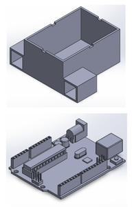

• SolidWorks 3D printed shell

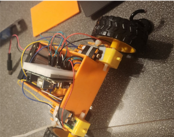

Step 1: Assemble the Chassis
• 3D print the chassis using the provided SolidWorks model.
• Insert the hobby gearmotors into the designated motor slots.
• Mount the rubber wheels onto the motor shafts.

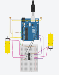

Step 2: Circuit Setup
• Attach the Arduino Uno onto the breadboard.
• Wire the circuit based on the circuit diagram shown in the poster:
• Connect photoresistors to analog inputs (A0, A1).
• Connect motors through the L293D motor driver.
• Wire the motor driver to the Arduino’s digital output pins.
• Use Wago connectors or solder where necessary.
Step 3: Secure Components
• Zip tie or tape the Arduino, breadboard, and battery securely to the chassis.
• Route wires carefully to avoid tangles or contact with moving parts.
• Ensure photoresistors are exposed and facing forward.

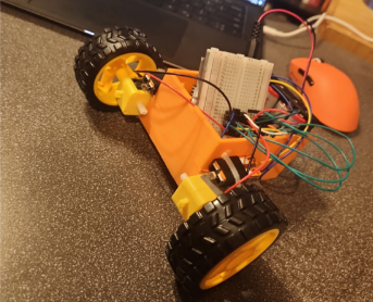

Step 5: Test the Car
• Place the car on the floor.
• Shine a flashlight in front of it—observe it follow the light.
• Confirm it avoids obstacles and adjusts direction as expected.
