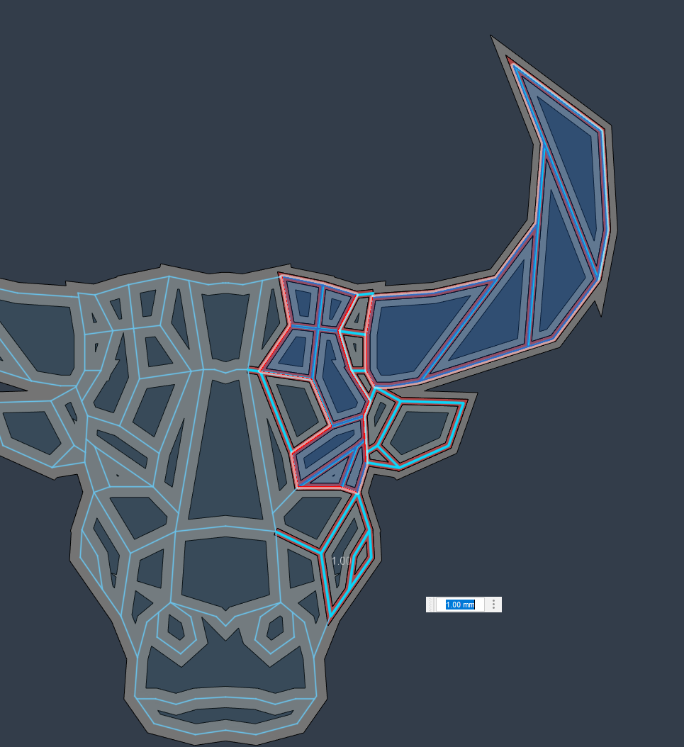

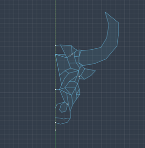

I've just started using Fusion360 and found myself googling a bit to understand what I need to do. Since it is relatively easy to create a flat 3D model and the software is free, I decided to give you a full rundown of what I did. I'm sure you'll be able to follow along even if you've never used Fusion360 before.
  1. Open Fuison 360 and create a new sketch
  2. Start by placing a long vertical construction line (click on the first icon behind "Linetype"). This line will be our mirror line. Deactivate the construction line type.
  3. Add more normal lines on either side until you are happy with your design.
  4. Select all the lines except the horizontal line and choose "mirror" from the "create" tab. In the new window that opens, click on "Mirror Line" and then on the line you placed in step 2.
  5. Open the "Solid" tab and select "Extrude". In the window that opens, click on "Thin Extrusion", uncheck " Chaining" and click on each line individually. Once this is done, set "Distance" to 5mm, "Wall Thickness" to 4mm and "Wall Location" to Centre.
  6. Open the "Sketches" folder on the left and double click "Sketch1". Repeat step 5 but set Distance to 1mm, Wall Thickness to 1.8mm, Wall Location to Centre and Operation to Cut.
  7. Lastly, click on File, Export and select STL from the drop down menu.
You will notice that the design linked above has small holes in it. I put them there to make it easier to remove the wire at the end, but I didn't use them. So I have decided to leave them out of the description.

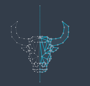

Step 3: Plan Out LED Location (20min)
We need the LEDs to separate the positive wire from the negative wire. It takes a bit of thinking, but for most designs there are a lot of possibilities, so everyone can find something they like.
Simply open your design in Paint and draw some coloured lines + dots for the LEDs until you are happy with the amount and location.
