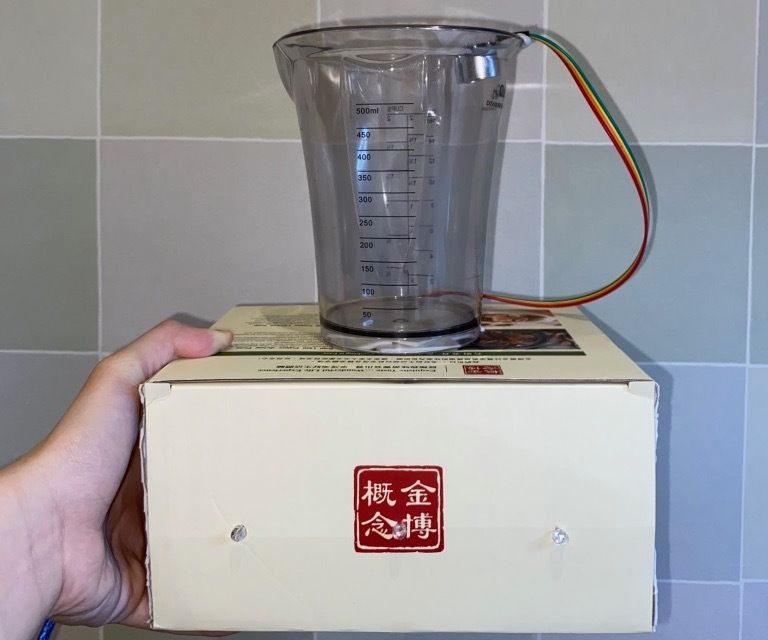

  • 2 LED lights (the project below uses one blue and one red)
  • 8 lines (wires)
  • 2 yellow resisters
  • 1 blue resister
  • 1 light sensor
  • 1 Arduino
  • 1 breadboard
  • 1 half-transparent box
  • 1 cable (connecting line for Arduino and computer)

Step 2: Build the Circuit
- Connect positive charge with 5V and negative charge with GND.
- Add two LEDs on the breadboard.
Connect one leg of the yellow resister with the shorter leg of the LED (on the same line) and another leg on a negative charge. As for the longer leg of the LED, connect it with a wire and on digital 9 or 6 (optional for which digital, but the code provided in the next step would use these two).
*Repeat twice for both LEDs*
- Insert the light sensor in wires so it is longer which will advantage in later
Connect one leg with analog In 0, or A0 (optional for which analog, but the code provided in the next step would use this). With the same leg, connect it with the blue resister which another leg of the blue resister will connect with negative charge. Another leg of the light sensor will connect with a wire which will connect to positive charge.

Step 5: Decorate
Cover the whole breadboard and Arduino with the half-transparent box. Remember to put the light sensor out of the box.
把麵包板和Arduino用半透明的盒子蓋起來,記得要把光敏感測器放在盒子外。
Step 6: FINISHED!!
View the video and see if your project looks the same.
*The project is set on purpose that the darker the outside is, the lighter the LED will be. Same on the opposite, the lighter the outside is, the darker the LED will be.
