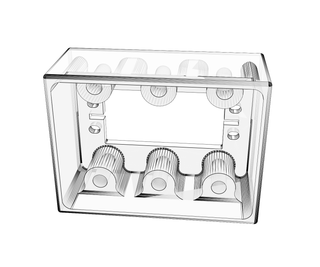

Got the CCL lights from Xoxide, got the 6mm laser diodes from an eBay shop, got the 60cm x 90cm mirror (back and top) from LOWES.

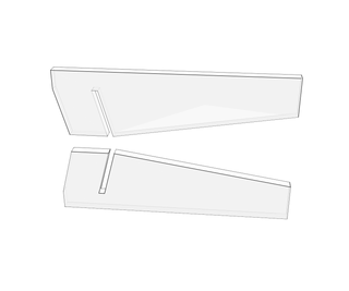

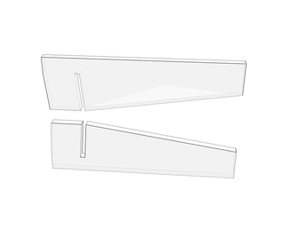

Print the parts from this instructable ... the mirror stands are 5° and 10° and 15° leaning forward for the back mirror ... try'm out see which looks best from your windows.

I still need to get a bunch of Yellow or Orange LEDs to add to the laser boxes and other parts of the display, but those are minor bits from the main show which is here now.
