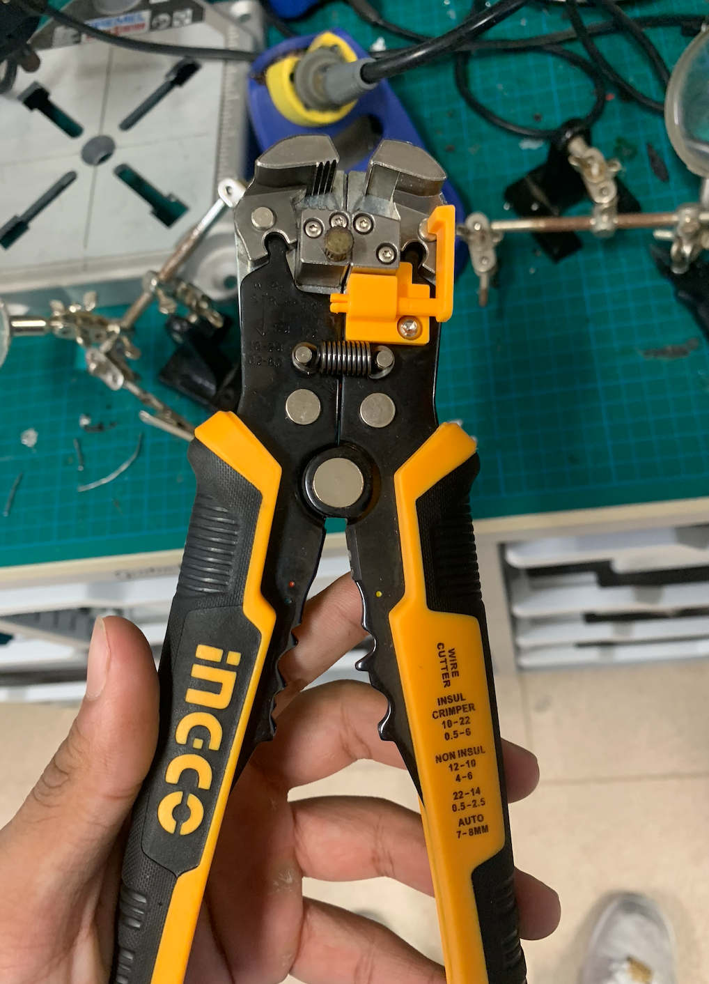

The tools you will need are a soldering kit, wire strippers, wire cutters and helping hands.
