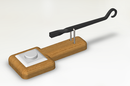

First, we need to build the light switch support.
Cute the plank. I put upside the drawing printed. The dimension aren't significant and you can adapt it to your light switch dimensions or to the place so you want to use. It's more easy to make this step using a band saw but there's no problem if you don't have anyones.
You need now to use your wood router to create a fillets. You can use 20mm diameter brush.
After this, you need to drill a hole with your push button diameter. Personally, I use a 68mm hole saw (standard for French electrical device)
Be careful, If you don't use teleswitch on your installation, you need to create a toggle with a special device (push button 1st push = On, 2nd push = Off)

For this last step, you only need to bend the U beam support, thread it and fix it...
Mount the switch, the beam, fix the support on the ceiling just above your bed, attach the chain + handle switch off the light and good night! have sweet dream.
