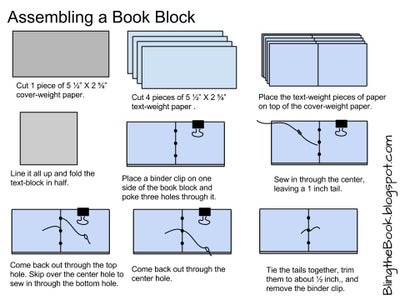

Step 3: Assemble the Book Block
Create a book block by folding the 5 1/2" X 2 5/8" pieces of paper in half. Insert the text-weight paper into the cover-weight paper and use a pamphlet stitch to sew them together.

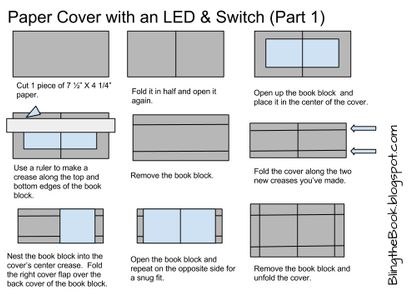

Step 4: Prepare Paper Cover
Fold the 7 1/2" X 4 1/4" piece of paper in half and lay the book block in the center of it. Use a ruler and bone folder to make a crease along the top and bottom edges of the open book block. After removing the book block, fold the cover at the two creases. Replace the open book block in the center of the cover (folded in two places) and wrap the left and right edges of the cover around the covers of the book block.
