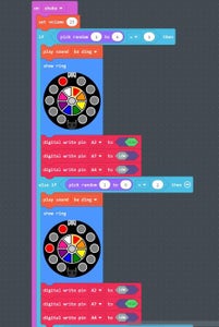

Step 1: Coding the Circuit Playground

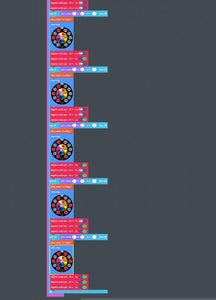

First, the Circuit Playground needs to be coded to randomly generate a number, 1-6, and then send the command to light up the corresponding amount of lights. As seen in the photos, all you need is one block of code. Select a purple input block and set it to "on shake." Now you are going to use six if/else statements in this block. If "pick random number 1 - 6" = 1, digital write the corresponding pin to high. Although the circuit playground will be inside of the dice in the end, I would recommend coding it so that the lights on the circuit playground light up. This way, you can ensure that the code is working correctly. Code the Circuit Playground so that each number will result in the correct amount of lights being lit up. The LED lights will eventually be threaded so that there is a group of 3 lights, 2 lights, and one light, equaling six total lights.
