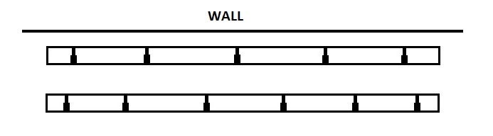

The plan was to make the shelf in two parts, the first fixed to the wall and the second fixed to the first. This would conceal the fixings and give the appearance of a floating shelf. As this was only for display purpose I was confident it would support the weight of the objects on it.
- The construction lumber comes with rounded corners, so the first task is to run the lengths through the table saw and square them up.
- Once squared the holes were drilled according to the plan. A 6mm hole was drilled all the way through, followed by a 10mm x 20mm deep counterbore.
- The front part then had a rebate cut all the way around to accept the LED strip.
- Both parts were then painted white.
- Once dry the back part of the shelf was fixed to the wall and then the front part fixed to it.
- The LED strip was stuck into the grove.
- The front counterbores were plugged with dowels, which I decided to paint blue (I may change that!)
