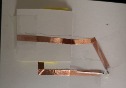

- On the back of the paper, you will use your copper tape to act as wires that will connect the LED to the battery. For a simple card with one LED, you can use a simple circuit, which means connecting the LED from the positive end of the LED to the negative end. You can only do this with one LED as the 3V battery can only light one 3V LED in this kind of circuit. You can use the same process as noted below with a parallel circuit for more LEDs, but I will keep this Instructable simple.
- Cut a piece of paper the width of the battery and more than double the length to create a rectangle. See #9 as to why we need this paper longer than the battery. 1cm longer should be enough.
- Fold the paper in half. This is where the battery will be sandwiched. If you need to, you can trace the battery shape onto the inside of the fold.
- Using the double-sided tape, tape the folded rectangle where you would like the battery to go (I recommend the corner of the paper with the open side of the fold facing the edge of the paper). Pressing the battery down will activate the light, so put it where you would like the recipient to press. The upper or bottom right is a good place.
- From one hole that was made for the LED, stick the copper tape down and lead it to where the battery will go. This should lead to the opened taped-down section of the "sandwich". If you need to create a corner, you can easily do that by pressing the tape to the corner of where you need to make the turn, turning the tape in the opposite direction of where you intend it to go and pressing down, then continuing to follow the direction you need to go in. See the image where there are corners. If it doesn't look clean, that's okay! People won't see it. Just make sure not to tear the tape. This is the instructions for how I made the bottom link to the circuit in the picture. The tape must cover the space where the battery will go.
- Do the same thing as #4 but for the other hole for the LED. Lead this copper tape along the open folded piece of paper you made and around to the other side (see picture).
- Bend the legs of the LED at a 90-degree angle. Fit your LED prongs through the holes. Bending the legs first will allow the LED sit flatter against the card and will allow the light to disperse more. The LED should sit sideways once pushed through the holes (see image of card from side).
- Bend the legs of the LED back and tape them down so that each leg is touching a different piece of copper tape (see picture)
- Place your battery down where you wanted it to go (in the paper sandwich). Press down to make sure that your LED lights up. If it doesn't light up, flip the battery around to make sure the positive and negative ends are matching. If it still doesn't work, make sure a piece of copper tape is touching both sides of the battery and both ends of the LED. Make sure the legs of the LED aren't touching any other pieces of copper tape as it would interrupt the circuit.
- Once you know your LED can light up, place double-sided tape on one end of your foam and cut it into narrow strips. Use small strips of foam to cushion your battery. This should hold the battery firmly in place and will give it space so that it the circuit isn't activated unless the battery is pushed.
- Tape the flap of the folded paper down with regular tape - but not too tightly as to activate the LED without pressing down. This is why we cut the rectangle longer than the battery.
