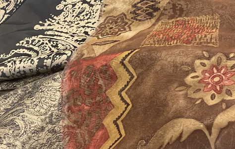

Step 3: Measure and Cut Fabric
Now that we have our code down, we can move onto the garment construction.
First, pick out your fabric. I decided to have only 2 layers, but you can have as many layers as you'd like. The steps are the same each time.
Once you have picked out your fabric, lay them out and measure 2 rectangles. The length and width of the fabrics do not matter as they will only determine how long your skirt is. My bottom layer was 46in long and 34in wide, and my top layer was 35in long and 25in wide.

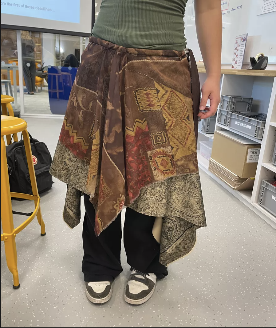

Step 11: Put Everything Together!
Finally, put on the skirt, tighten it with the strip of fabric that you threaded into the casing, tie the strip of fabric with the light onto your waste, attach the battery onto it from the inside, and walk!
