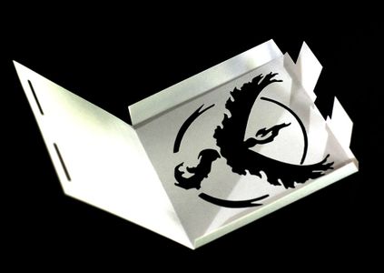

- Cut out the team logo and the envelope template
- Cut the square of vellum or tissue
- Cut the rectangle of cardboard
- Pre-bend and crease the envelope
- Attach the cardboard stiffener to the inside of the back panel with adhesive
- Attach the tissue square to the inside front (logo side) with adhesive
- Fold the back panel onto the front panel so that the cardboard and tissue are touching

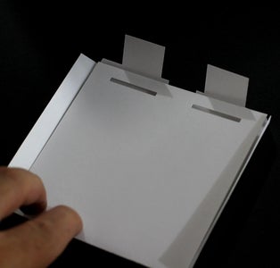

- Insert the EL-panel into the envelope with wires extending from the open (top) edge
- Fold the two top tabs over the back panel and insert them into the slots on the back panel

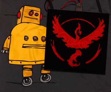

- Plug the wires from the EL-panel into the Inverter
- Turn the inverter on, click once more for slow blink, a third click makes it blink quickly
- Go hunting with your new, wearable, glowing team logo.
