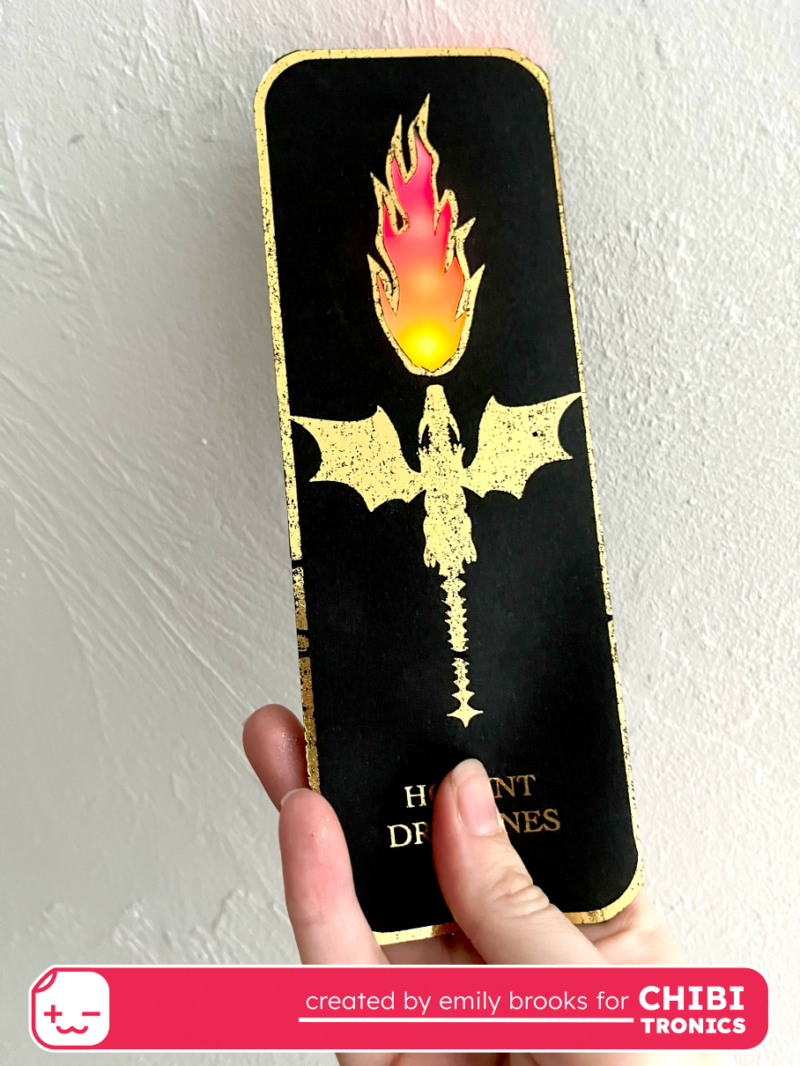

For all my fellow dragon-loving readers, this light-up bookmark is for you! Did you know that cartographers inscribed “Hic Sunt Dracones (Here Be Dragons)” in a copper globe over 500 years ago? On the back of this bookmark is a map near the edge of the Northern Hemisphere, and on the front is an aerial view of a fire-breathing dragon.

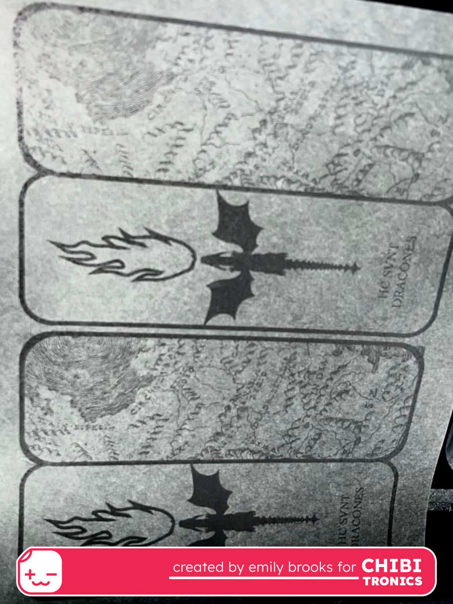

Print the PDF on black card stock with a black toner printer. Do not use inkjet!
For demo purposes, this image depicts the PDF printed upon gray paper. I suggest you print the design upon black card stock.

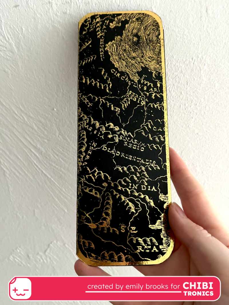

Use non-permanent tape to attach metallic toner-reactive foil to the printed side of the card stock.
Run the foil/ card stock sheet through a thermal laminator twice.
Peel the foil from the card stock.

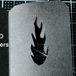

Use a craft blade to cut around the edge of the bookmark as well as the inside of the flame.

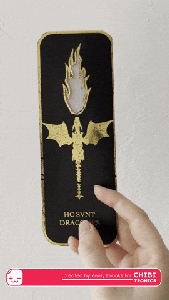

Step 4: Assemble Circuit

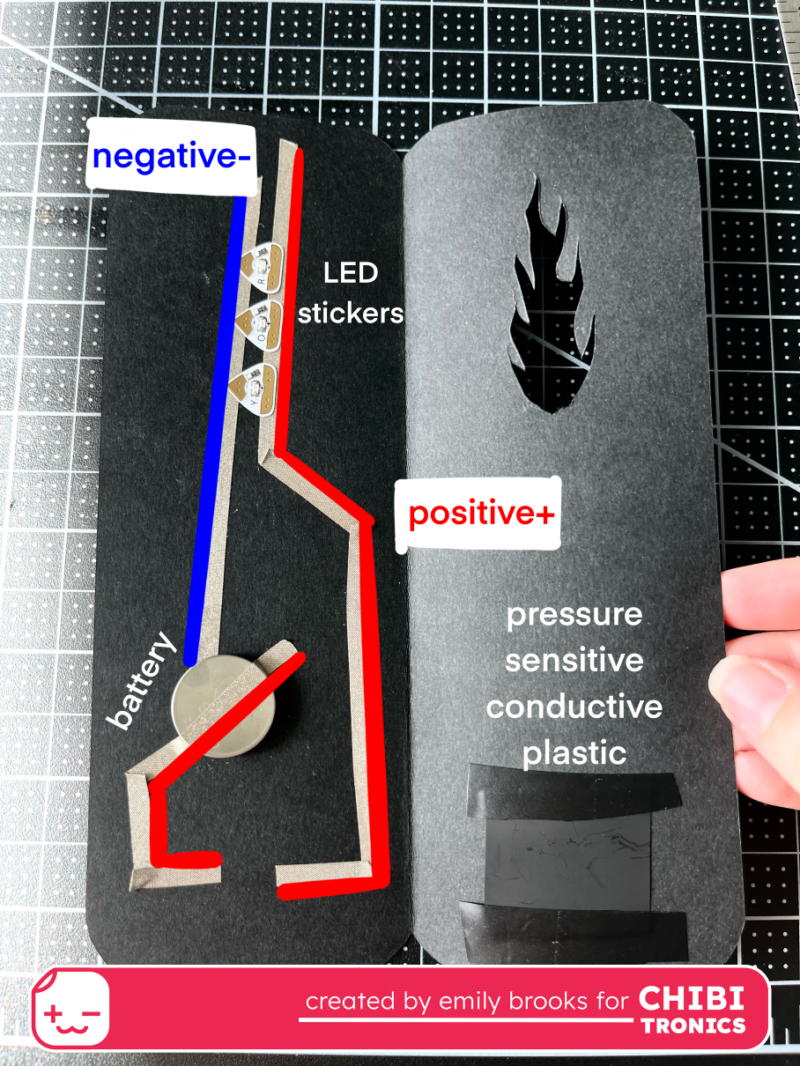

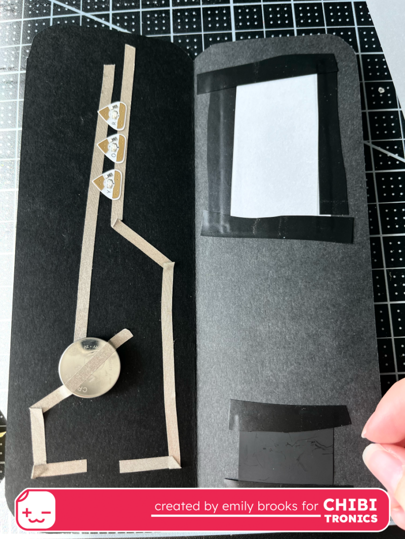

Use conductive fabric tape, a coin cell battery, and the red, orange, and yellow circuit sticker LEDs to create the circuit on the inside of the bookmark, leaving a gap as seen in the image.
Tape a small strip of pressure sensitive conductive plastic to the other inside of the bookmark to allow the circuit to complete when pressed.
Step 5: Finishing Touches
Tape a strip of vellum behind the flame cut out to diffuse the light.
Tape the bookmark shut.
