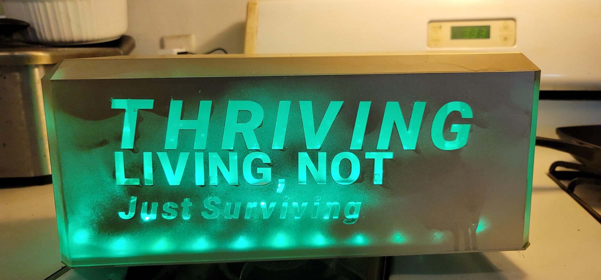

Step 8: Finish
Turn on the lights and enjoy. These boxes are amazing at night in the dark. They look beautiful and are so fun to make.
