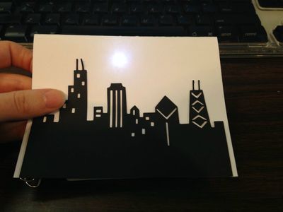

  1. Fold your 1/2 sheet of white card stock in half to create a card.
  2. Cut skyline out of black card stock. You can draw a simple skyline, print one from online and trace it, or go all-out like we did and design one to be cut on a Silhouette Cameo cutter. The important part of these instructions is the inside of the card, so I'm trusting you to make a killer skyline on your own.
  3. Glue your skyline to the front of your card.
