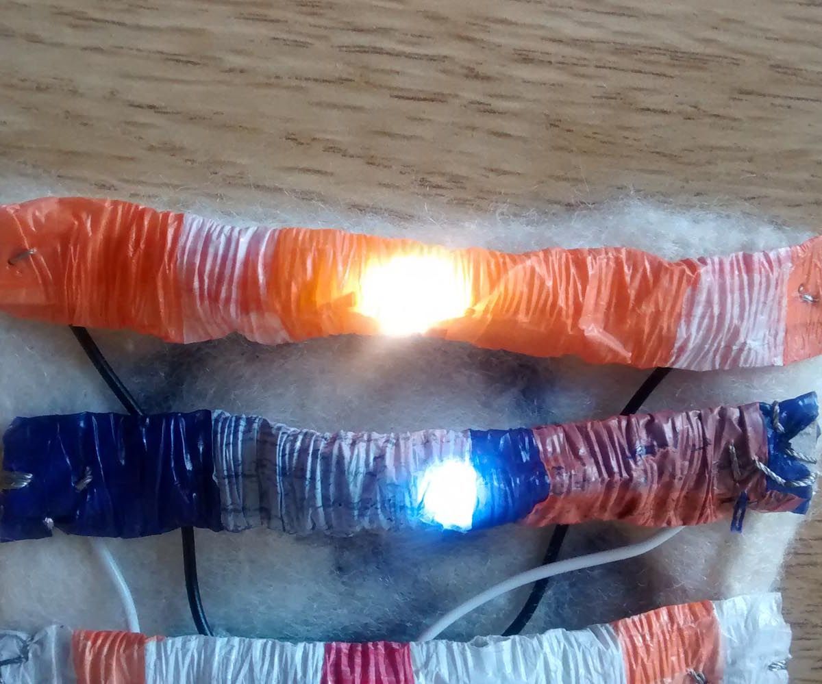

I have been experimenting with textiles projects that involve electronic elements. Having found a great selection of products available from Kitronik ( a Nottingham based company: kitronik.co.uk) I decided to adapt one of their 'Sound Meter Kits' to create a device that lights up when my phone rings.
I wanted the device to be versatile, so I used press studs (a.k.a. poppers) which are conductive connectors. I can now 'pop' my device onto a variety or surfaces and use corresponding LED beads with press studs to adapt the circuit further.
The concept has a lot of potential to be taken further but you are welcome to follow my steps and create a Light Up device of your own...

Because of the press studs it is possible to connect this device to a range of products depending on preference. I created:
- One laser cut wooden wall hanging that had a shelf to hold the phone. I used wire and soldering around the back to attach the press studs and LEDs
and
- One clutch bag with LED press stud beads. I used conductive thread to sew the press studs to each other creating a continuous circuit.
The possibilities are only limited by time, patience and press stud availability!
