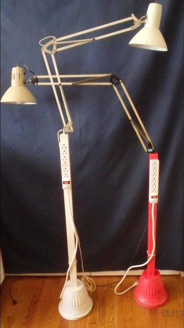

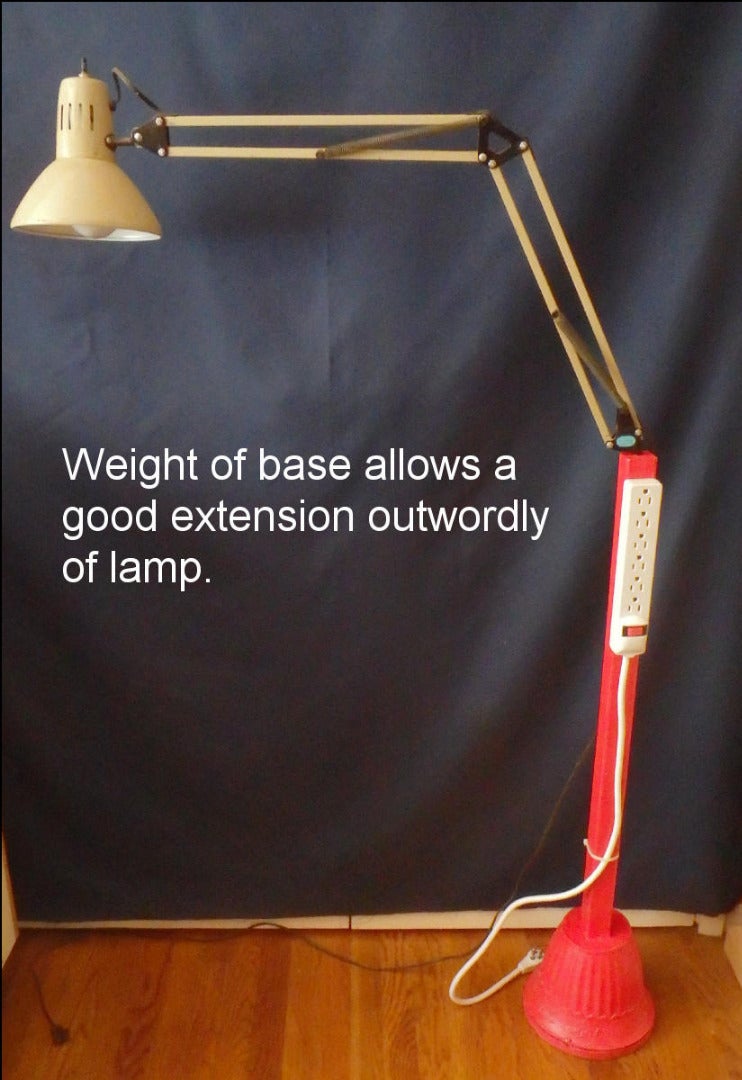

I came up with this solution for a common problem: our house doesn't have enough outlets in any of the rooms so we were always using extension cords, multi outlets, electrical boxes, etc. In addition, the art table, hobby/craft work stations always needs lights. So I decided to solve both issues with a portable, solid, and easy to use light/multi-outlet stand. Basically, it's a wood upright secured to a round plywood base. A plastic flower pot has the bottom cut off, turned upside down, attached to the base and concrete is added to insure stability. Let's proceed.

Step 8: Proceed to Fill Flower Pot Vase With Concrete Mix
Now that the pot is secured to the base, the concrete mix can be mixed and poured. I used the mix shown and for this project, about 7 14.5 ounce cans of dry mix are needed. To this mix in the tub I added about two cups of clean water. I want a fairly fluid mix, one that will be easy to place in the small opening of the flower pot. Obviously, these measurements might vary for your set up depending on size of the pot, the humidity, and other variables.
Step 9: Let Concrete Set Up
Let concrete set for 24 to 48 hrs. I want to let it dry thoroughly so the moisture won't interfere with the paint used.

I cleaned up the base and upright to make sure paint would adhere. Using common acrylic paint, two coats were used to provide adequate coverage.
Step 12: Glue a Piece of Felt on the Bottom of Base
To protect hardwood floors and other susceptible finishes, a piece of felt is glued onto the bottom of the base. At this stage, the project is complete!
