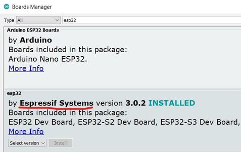

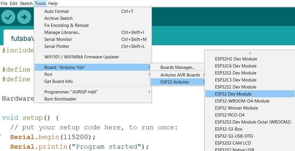

Open your Arduino IDE, make sure that ESP32 board library was installed (In version 2.0 we can just search ESP32 in board manager section), and you are good to go. Oh, one more thing, connect your ESP32 to your computer and select ESP32 Dev Module in Tools -> Board -> ESP32 Arduino. Now you are ready to the final step.

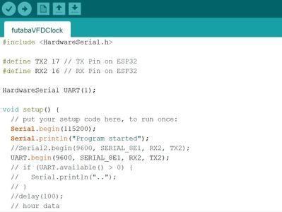

Hooray! Now you can open the demo program and upload the dreamy codes and -- wait for the display to work (sometimes you need to push the reset button on ESP32 after the upload). Oh one more thing, since you cannot find any datasheet of this module on web, I am going to simply explain what's happening and how you can change the display:
UART.begin(9600, SERIAL_8E1, RX2, TX2) is to initialize the communication which you don't need to change
UART.write(...) is the send data through the UART communication and here is the command set
0xFE -> 0xFD -> 0x01 -> 0x00 Light off all
-> 0x01 Light on all
-> 0x02 -> hour data (in hex format)
-> 0x03 -> minute data (in hex format)
-> 0x04 -> 0x00 Colon off
-> 0x01 Colon on
Using for example UART.write(0xFE), then 0xFD 0x01 0x00 you finish the light off operation...
