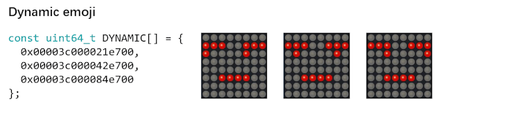

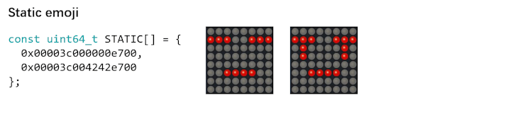

The plan for this project is to display the static emoji (crying face and waiting face) when there is no left or right gesture been read.
Display dynamic eye-position-change emoji with controlled by left or right gesture when there is left or right gesture been read.

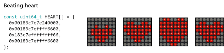

At the specific eye position, a beating heart will be displayed on the LED matrix.
The LED display patterns are designed by LED Matrix Editor, you can change or add your LED patterns in program shows above.

In the main loop, we only take two outputs from the gesture sensor, GES_RIGHT_FLAG, GES_LEFT_FLAG and these are used to guide the displayDynamic() function.
The displayDynamic() function will calculate the interval from last time dynamic emoji was displayed to current time, if the interval exceed than TIMEOUT, it will stop playing static emoji, and set displayed dynamic emoji index to start. When left-to-right gestures are read, the start index is 0, and the index will be increased after left-to-right gestures read again. Otherwise, the start index is the last index of DYNAMIC array, and the index will be decreased.
