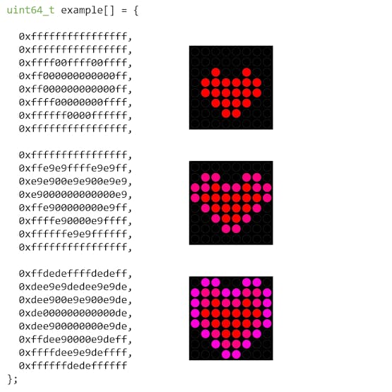

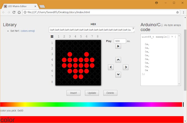

And click here to get image editor to create your own images. Choosing color in color bar, clicking dots in drawing area to draw, and pushing Update or Insert button in bottom of drawing area, your image will be converted to code and display in the box on the right.
My image looks like below. You can copy that code displayed to your project, and then show them in RGB LED matrix by coding.
