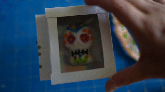

Step 1: Cut Out the Nicho Box
There are two parts to my nicho template. The first part is a foldable box. If you’re able to print on a heavy paper like cardstock, you can print this template directly onto your paper. Otherwise, you’ll need to transfer the template onto your cardstock paper. I have access to a Cricut and used the machine to cut the template, and draw the fold lines.
Don’t assemble the box yet! It’s helpful to do the circuitry and decoration first, and assemble at the end.
If you’d like to edit the design of the foldable box you can access my design file on Cuttle.
Step 2: Cut Out the Nicho Box "Face"
The second part of my nicho template includes a few different designs for the “face” of your nicho. Pick one and cut it out using the same process you used for the box.
You can also layer multiple faces to create an interesting effect.
Feel free to cut or design your own nicho box face. Just make sure you leave a window in the middle of the shape that is 2” x 2.5” or less.
Don’t glue the face to your box yet! There are a couple more steps to take care of first. I recommend cutting out all of these pieces first because I think it’s helpful to see the box and the face as I’m planning my decorations.
If you’d like to edit the design of the nicho faces you can access my design file on Cuttle.

Step 12: Assemble & Decorate Nicho
Now you’re ready to put your nicho box together! Here’s the order of assembly that I recommend:
First, decorate the inside of your nicho. You can cover the back wall of the nicho with a photograph or decorative piece of paper. You can glue decorations to the bottom or sides of the box.
Next, fold the box and glue the flaps on the front. A small dab of glue where the flaps overlap should be enough to hold the box together.
Then, decorate your nicho face. It’s easier to paint, draw, and glue things to your nicho face when it’s separate from the box.
When you’re done decorating the nicho face, glue it onto the nicho box.
If you’re not using a Chibi Chip, this is the final step! Turn your lights on using a coin cell battery and battery pack of your choice and enjoy your creation.
