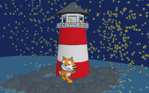

Students will upload this asset to Scratch to animate the rotating light, ocean scene, sound effects, and/or Face Sensing interactions.

For example, a lighthouse could be used as:
  1. scenery, where we add a rotating light and an active ocean scene behind it in a storytelling project

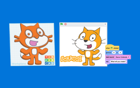

Step 8: Optional — Try Controlling Sprites With Your Face!
Want a challenge that gets your body moving? Try using Scratch’s recently launched Face Sensing blocks and the features of your face to control the animation!
These AI-powered blocks use a machine learning model to detect if they see a face and where a nose, eyes, ears, mouth, etc., are. When you use Face Sensing blocks, only your computer can sense your face. None of your data is stored or sent to Scratch or any other site. Making it a safe, fun, and creative way to explore the possibilities of AI.
  1. Add the Face Sensing extension blocks by clicking on the extension menu in the lower-left corner of the project editor. Face Sensing blocks use the device’s camera. If you haven’t enabled the camera in your browser, you may be prompted to give permission.
  2. Click the “go to nose” block while your face is visible on the stage. Did the sprite go to your nose? What if you choose another feature?
  3. How can you make the sprite constantly follow your nose? (Hint: try a forever loop.)
  4. How can you utilize additional blocks (like “turn clockwise 15 degrees” from the Motion category) to add more animation?
Scratch’s Learning Resource Designer, Maren, has shared an example Scratch project (projects/1216333706) using Face Sensing blocks to demonstrate some possibilities. In this example, the boat continually goes to one’s mouth, and is coded to change costumes if touching the water or not. The light on the lighthouse is angled based on the angle of the face tilt.
