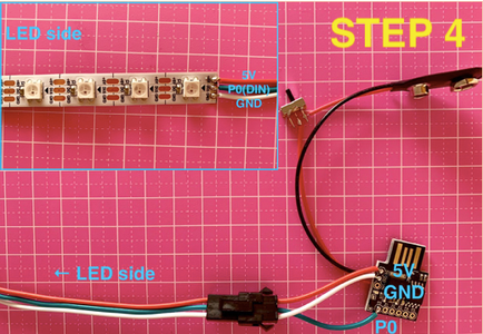

STEP4: Then solder 3 wires for LEDs to the frontside of the board.
5V - (LED) 5V: Red wire in the example
GND - (LED) GND: White wire in the example
P0 - (LED) DIN: Green wire in the example
Solder 2 LED tapes together. Be careful to solder them same direction shown as the arrow mark.
STEP 5: It will look like this. I suggest to put glue gun on soldered part to reinforcement.
