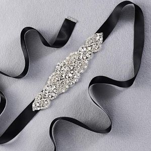

  3. Black Sash Belt to put the color sensor on

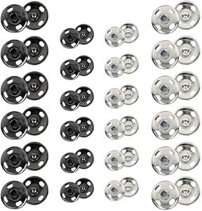

  4. Snaps - this is how the belt and the petticoat are connected to the dress

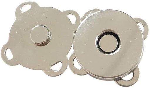

  5. Magnetic Buttons to connect the petticoat to the dress from the inside
  6. Metal Snap Buttons to connect the belt to the dress

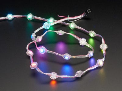

  11. 9 x Adafruit NeoPixel LED Dots Strand - 20 LEDs at 2" Pitch 180 LEDs all together

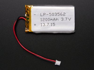

  13. Lithium Ion Polymer Battery - I started with 3.7v 1200mAh but needed to go up to 3.7v 5000mAh to support the 9 stands. If you're using less/more, check out the calculations in the 'Additional Resources' below. The 5000mAh one I got from Amazon had the black and red wires switched so you need to switch them back.

The Adafruit NeoPixel LED Dots Strands come with black plastic connectors. You can take the end connector, clip it off of the last strand and use it to connect the first strand to the microcontroller (Gemma in this case). This gives a good explanation on how to do this properly. Although I think they meant male connector and not female.
You'll also have 2 additional wires coming out of the (I think) female connectors, you can clip them, they won't be needed.

The solution - snaps! Or to be precise conductive snaps.
The idea was to snap the petticoat to the dress, then snap on another element on top of the dress (the belt) to hold the color sensor and then run conductive thread from one set of snaps to the other. This will also enable connecting the belt and the petticoat to another dress/skirt.

  3. Decide on the placement of the snaps. For the petticoat to dress snaps I used the larger magnetic buttons. You can go with either 4 snaps for just the color sensor or 6 snaps for both the color sensor and the on/off switch. You need to space them to make sure you can create separate connections that don't cross each other. And plan the order right so that you have direct lines to the place where the belt will be connected

  1. Decide on the placement of the belt relative to the dress and where you'll position the belt snaps. I'm using the smaller snaps for the belt. Lastly, trace the lines between the belt connections and the petticoat connections to ensure separation of the lines.
  2. Remove some of the jewels on the belt to make room for the color sensor. I'm really happy with how this turned out. It looks as if its always been like that.
