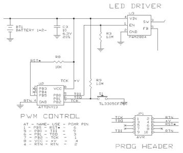

Step 1: The Circuit Explained
The complete schematic is shown here.
Step 2: The Charger Circuit
There are three parts to this schematic and I will explain each section. The first is the battery charger.
This uses a micro-usb B connector, P1, as the input. The battery charger ic, U1, is a smart charger that will charge the battery, BT1, to 4.2 Volts maximum. It will detect if a battery is present and if there are any problems with the battery. The charger will set the STAT pin, U1-1, to a low condition when charging. This will turn on the LED, D1. D1 will turn off when the charge is complete.
Here is the link to the MCP73832 datasheet:
https://www.microchip.com/wwwproducts/en/MCP73832
Step 3: The Microcontroller
The next section is the microcontroller. I use a small ATtiny13A from Microchip as it is inexpensive and can operate in a low power mode.
The circuit board uses a programming header to allow easy connection to the Atmel-ICE programmer. There are pull-ups and pull-downs to ensure proper states are on the key pins of the microcontroller, U2. Pin 1, RST* needs to be held high, R8, so that the controller does not reset itself accidentally. R9 is used to ensure the signal on pin 6 is kept high and only goes low when the button, S1 is pressed. R3 is keeping pin 5 low, or the EN of the LED driver, to ensure that the LED is off.
Here is the link to the ATtiny13A datasheet:
https://www.microchip.com/wwwproducts/en/ATtiny13A
Step 4: The LED Driver
The last section is the LED driver itself.
The LED driver, U3 PAM2804, is a PWM controlled driver. PWM means pulse-width-modulation. When the EN pin is set high, the driver turns on the output and lights up the LED to full brightness, but when this is pulsed low, the driver turns off. Thus, if the signal is high half the time and low the other half, the brightness is about half of the maximum. If it is high for a quart of the time, the brightness is about a quarter.
The inductor, L1, helps keep the current flow constant as this operates in a buck, or step-down, power supply configuration.
The LED used in this project is similar to ones used in streetlights. Thus, this is a VERY bright LED that can handle much current. The driver, when on, is driving the LED to the maximum brightness, but this is controlled by measuring the current through the LED. This current is sensed as a voltage on R4.
Here is the link to the PAM2804 datasheet:
https://www.diodes.com/part/view/PAM2804

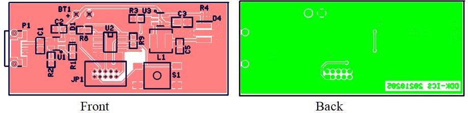

Step 5: Board Layout
The circuit board in these files have all the parts on one side, but is double-sided. The LED, D4, is very bright and can handles a lot of current, it also generates heat. So this board design has extras through hole vias to help dissipate the heat. Thus, the reason it needs to have two sides. There are also a few traces that run on the back of the board to make all the necessary connections.
There are several pcb board houses in the market. I use SunStone.com since they have good prices and deliver quickly. The file flashlight_gerbers.zip contains all the necessary files for the pcb house to build your board. The attached file flashlight_gerbers.zip.txt should be renamed to flashlight_gerbers.zip. This file can be sent to the board house, and they can send back a bare pcb.
The parts list for electronic components can all be obtained by my favorite distributor, DigiKey. I even included the distributor’s part number.
Step 6: Board Assembly
Using a soldering iron, start with the smallest components first; these would be the resistors and capacitors. Then the ICs U1 and U3. Then the inductor L1 and D4. Add the U2 microcontroller and then JP1 and S1. A fine tipped soldering iron is recommended. When soldering the D4 LED and L1, be sure to allow the solder to fully melt and flow under the components. These D1 and L1 are the most challenging to solder. Ideally if you can get access to a heat gun that does not blow hard, but hot enough to melt solder, it makes the assembly of these two parts easier.
The last item to install is the battery itself. Solder the black, negative, lead into the hole on the right. Then solder the red, positive, lead into the hole on the left. There should be a “+” sign nearby.
