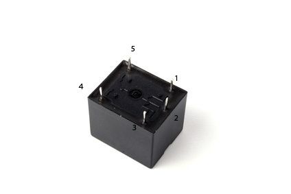

RELAY
check the picture of the relay,
Connect 1 and 3 pins of the relay to the circuit it has no polarity and connect the pins 2 and 4 to the device you need to switch
