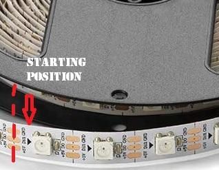

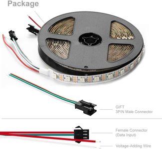

After you kids complete their drawings, it's our job to maximize their satisfaction. Teenagers may also involved in the building of this RGB full-colour drawing frame. You are free to choose from old paper boxes with flap opening or photo frames for modification. In order to create mesmerizing effect, we use an Arduino UNO to drive an individually-addressable RGB LED strip for the light pattern we want. You are free to cut across any point on the copper contact points to make the strip fit in your frame. For example, the red dotted line in my photo can be the starting point of a strips of 52 LED bulbs for my wooden drawing frame. Please notice that the power (5v) can be applied to any anode and cathode copper contact points on the strip, but the digital control pin should be the one before the first LED bulb (the starting position in my photo). For detailed technical data, please refer to tweaking4all.com.
