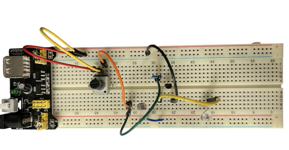

Step 1: Breadboard Circuit
The LDR circuit uses a light-dependent resistor (LDR) and a potentiometer to form a voltage divider that senses light levels. As the light on the LDR changes, its resistance changes, altering the voltage sent to the base of a transistor. When this voltage crosses a certain threshold, the transistor switches on, allowing current to flow to an LED or other output device, which then turns on. Essentially, the circuit detects changes in light and responds.
1. The LDR is connected in a voltage divider with a fixed resistor or a potentiometer. This means the voltage at the junction between the two changes depending on the LDR’s resistance.
2.This voltage is sent to the base of a transistor. The transistor acts like a switch.
3.When the light level changes, the LDR’s resistance changes, which changes the voltage at the transistor’s base.
4.Once the voltage reaches a certain threshold, the transistor turns on, allowing current to flow through the output device (like an LED or buzzer).
5.The LED or output device lights up or activates in response to the light detected.

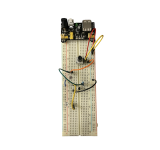

HOW THE BREADBOARD WORKS:
A breadboard lets you build circuits without soldering.
  1. The side rails (+ and –) are for power—they connect all the holes in a row.
  2. The main area has columns of connected holes where you plug in components.
  3. Components in the same column are electrically connected.
  4. Wires (jumpers) connect different parts of the circuit.

Breadboard Setup
  1. Connect + rail to red wire of battery holder.
  2. Connect – rail to black wire of battery holder.
LDR and Resistor
  1. Place LDR and 50 kΩ resistor in series.
  2. One end → + rail, other end → – rail.
  3. Junction between them → Base of transistor.
Potentiometer
  1. Connect outer pins to + rail and – rail.
  2. Middle pin → adjustable sensitivity.
Transistor (BC547)
  1. Emitter → – rail
  2. Collector → short leg of LED
  3. Base → junction of LDR and resistor
LED
  1. Long leg → + rail (through resistor if needed)
  2. Short leg → Collector of transistor
Power
  1. Insert 9V battery in holder.
Test
  1. Shine light on LDR → LED off
  2. Cover LDR → LED on
  3. Adjust potentiometer as needed
