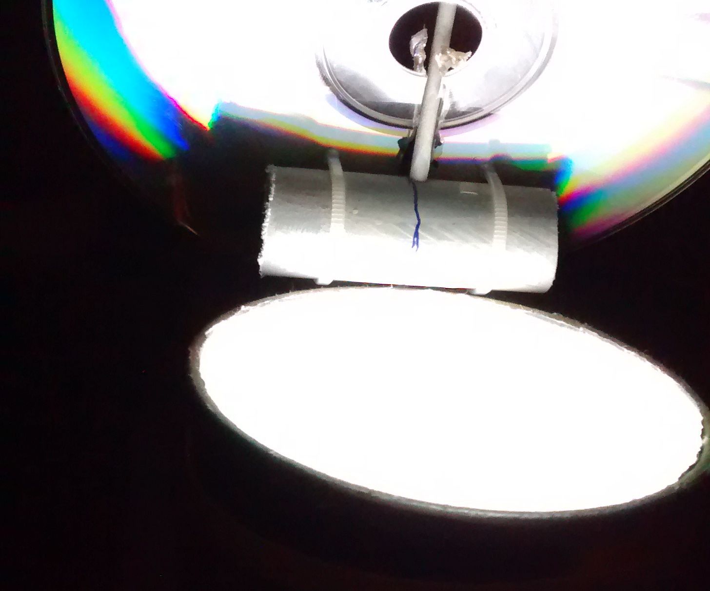

This is a simple mood lamp
i saw the bits and pieces lying around and the idea for this lamp formed in my mind
This is my first instructable so pardon the gaffes
i have a few other lamps which i will add in a short while

Step 2: The Heart of the Lamp
Step1:
using a PVC pipe mark a circle around the PCB
Cut out a circle
Step2:
Solder the LED's on the PCB in approximate circular pattern
Connect the LED's to each other
i made 2 LED's in series and 3 such pairs in parallel to have them work on a 5V adapter without any resistors
solder the connectors (you can use any type you have lying around) i chose berg strip connectors
Step3:
Cut two pieces of PVC pipe of 10mm and 20mm length
Cut one piece of PVC pipe of 30mm length
Make a lengthwise slit in the large piece
Step4:
assemble the parts the smallest PVC pipe, then the PCB then the second PVC pipe and clamp them with the large piece with the slit
use adhesive to join each part to the next
Step5:
bring out the connecting wires for easy access and connecting to the adapter
Step 3: Setting the Mood
cut the bottom from one paper cup so that it fits snugly on the PVC pipe
if the cut becomes large, pad it with some tape
join the second cup to the first at the mouth with adhesive or just tape them together
Step 4: Finish It Off
insert the paper cups on the PVC aseembly
Viola it is done
