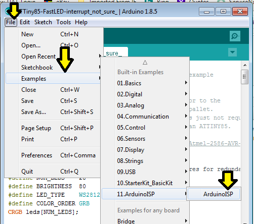

- Install the Arduino software on your PC. https://www.arduino.cc/en/Main/Software
- Connect Arduino to the PC and load the Arduino as ISP software.
- Connect Arduino with USB cable.
- Start the Arduino Software call an IDE
- Under the "Tools" menu - pick Board: Arduino/Genuino Uno
- Under port pick the port the Arduino is connected.
- Click on File and Examples.
- Click on 11. Arduino ISP
- Click on "Tools" menu then set the "Board:" to Arduino/Genuino UNO as the board being programmed.
- Make sure the Arduino is found under the Port Setting.
- Click on the "Sketch" menu then upload.
- You now have the arduino loaded as a Programmer. This will allow you to now program the ATTINY85. The first thing to do before we program the ATTINY85 is to get the board definitions loaded for it.

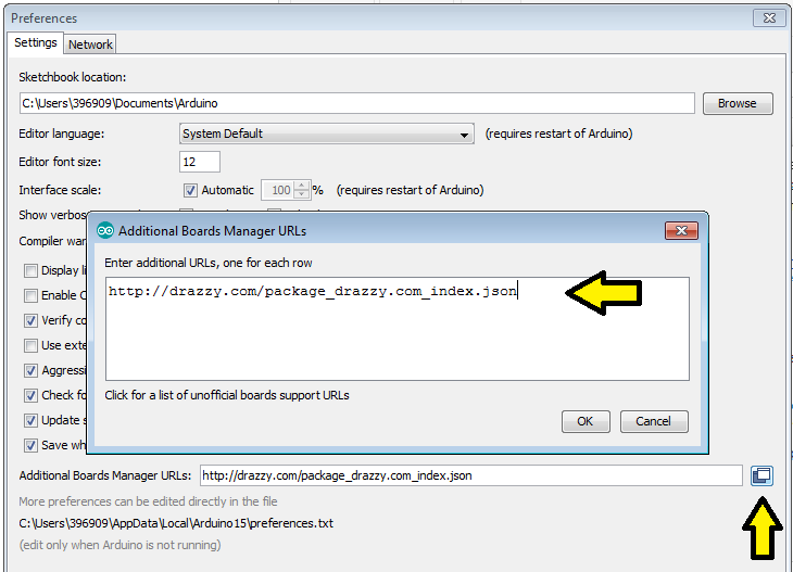

- Click on "File" then "Preferences"
- In the text area next to "Additional Board Managers URLs:" put: http://drazzy.com/package_drazzy.com_index.json
- click ok

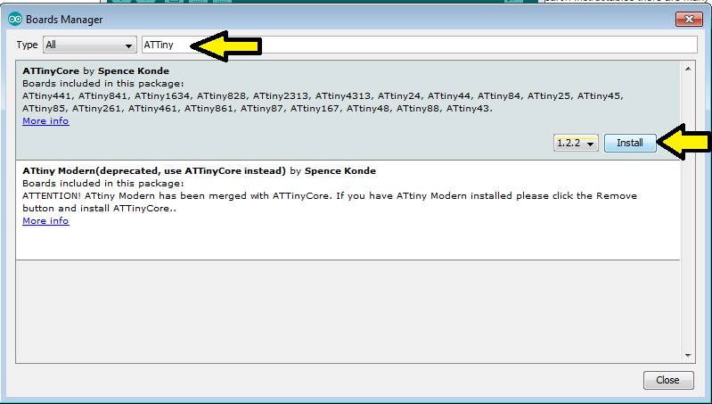

- Next click on "Tools" menu
- then go down to Boards.
- Click on "Board Manager..." on the menu.
- Type in ATTINY on the Search bar.
- Pick ATTinyCore by Spence Konde.
You are now ready to wire up your programmer!!!

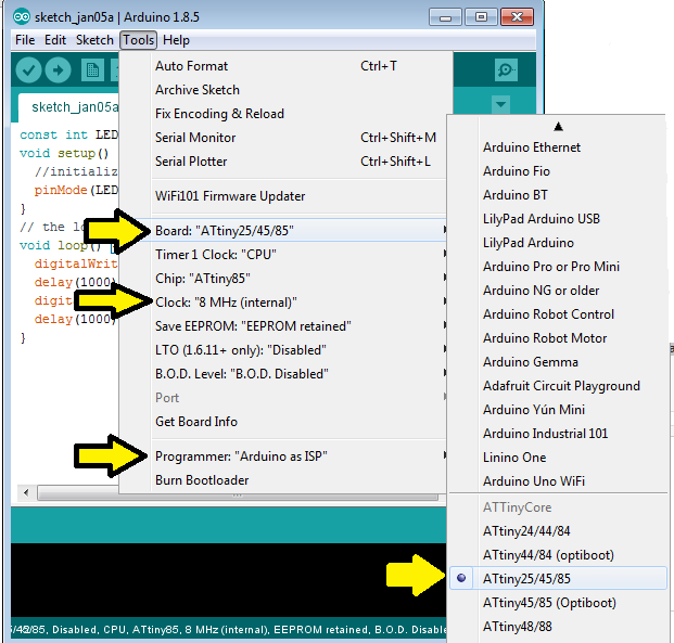

- Start the Arduino IDE
- Attach Arduino
- Make sure the board selected is still the ATTINY85 Clock: 8Mhz (internal)
- Verify the Arduino Com port is selected.
- Set the Arduino Programmer as "Arduino as ISP"

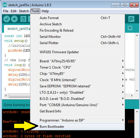

To burn a new boot loader
- Attach Arduino to PC with USB Cable
- Click on the "Tools" Menu
- Verify Programmer is still set for "Arduino as ISP"
- Click Burn Boot Loader

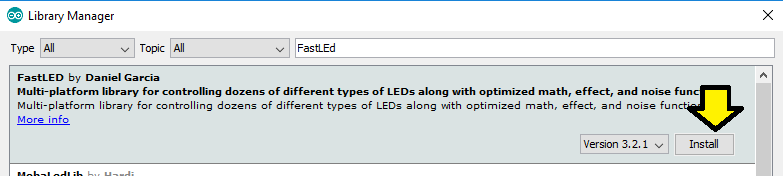

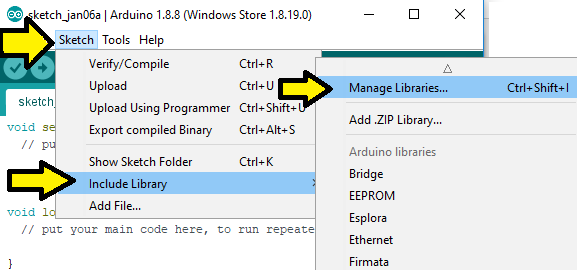

Before we can load the program we must first add the FastLED library.
To add the library, click on the "Sketch" menu. Next click "Include Library" then pick Manage Library on the top of the list.
Search for the FastLED module and install it.

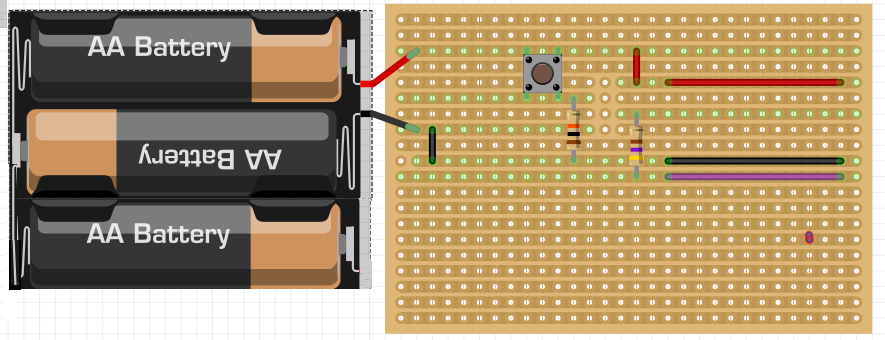

If you are going to use a breadboard or use a strip board you must refer to the pinout of the attiny85.
These pins are used if its soldered into a stripboard or on a breadboard.
- Pin8 is your voltage source. 4.5 v from batteries.
- Pin4 is ground or the - side of the batteries.
- Pin5 (PB0) goes to the data line on the leds. the WS2812b recommend a 470Ohm resistor between the pin and leds.
- Pin2 (PB3) is the pin our hardware interrupt is setup on. This also has a 10kOhm resistor to ground.
If you use strip board you need to use the 1/8th inch. I found it easier to solder in the socket, then remove the copper tracing between the pins. I use an ohm meter to make sure i got all the copper between the pin.
- First solder in an 8pin socket into the board so the ATTINY85 may be removed and reprogrammed.
- Remove the copper tracings between the pins with 1/8th inch drill bit.
- add the resistors.
- the 470 ohm from pin 5 (PB0) to the data in on the LEDS. I run two writes on the WS2812b
- the 10k ohm goes from ground to the pushbutton.
- + voltabe from the battery goes to the PIN8 on the attiny and the pushbutton

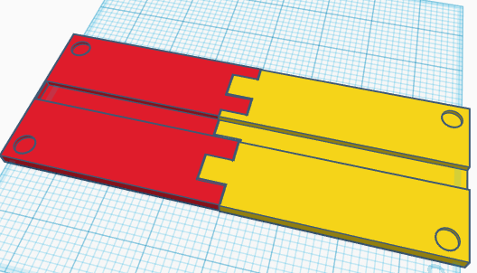

Step 9: 3d Printed Parts
I created a flat holder to put under my award, there is a groove that the LED strip fits. Since my 3D Printer doesn't print more than 6 inches I separated the parts in half.
I then created a small holder that would hold the batteries and the circuit board. I printed two of these and they fit over the battery and the board.
Although your project my be different from mine I will post the .stl files to give you a starting point.
