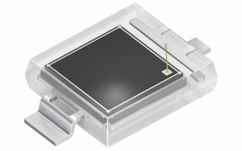

Step 1: The Photo Diode
As said the photo-diode is a "large-area" photo diode that is used in photoconductive mode. This means that it is reverse biased. So it does not conduct current, at least, it doesn't until light shines on it. You can think of it as though light makes the diode leak more current. The advantage of this mode is that it is much faster than photovoltaic mode (which is used in solar cells). For more information read the Instructable by Nqtronix or on Wikipedia :

The current of the photo diode is quite small, in the region of several micro amps. The SFH2440 has a maximum of 750 uA when it is in bright sunlight, under normal circumstances the current is less than 10 uA and in total darkness it is just a few nA.
This current is then fed to a trans-impedance amplifier (opamp U1B) that converts this current into a voltage with R1, with a value of 2k7 it converts 750 uA into about 2 V. A capacitor (C2) blocks the DC component of the signal and the AC part is amplified by a second opamp (U1A).
The dual-opamp is a low power MCP6002 from Microchip, its bandwidth-gain product is 1 MHz, more than good enough for audio. An advantage of this dual-opamp is that it works from 1.8 V to 6 V and uses 100 uA per amplifier. The total current consumption of the whole device is just over 200 uA so it can easily be powered with a CR2032 battery. Finally a potentiometer that was scavenged from a broken RC-servo, so the sound level can be adjusted.
