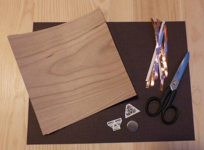

Step 1: Materials and Tools
Tools:
  • OPTIONAL: Laser cutter - I used YuKonstruct's Epilog 60 watt laser cutter. I used the laser cutter to do the card design, but you could also cut out your design by hand.
  • Scissors
  • Straight edge
Materials:
