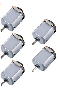

-3V mini electric motor

Step 1: Create Circuit From 9V Battery to Motor
-Want to connect the negative (black) to one side of motor, red wire to other side
-Solder each wire to the positive and negative node
(Note: Once circuit is closed, the motor will run. Do not want propellor attached to motor at this time)
-When you test that the motor and battery work, cut the red wire in half and strip both the ends.
Step 2: Connect Switch to Red Wires
-One end of the red wire connects to the switch node, repeat with the other. Solder into place.
-The switch should now turn on and off the motor.
