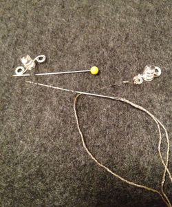

First determine the positive and negative leads on the LED. You can tell in several ways. Unless you have a very SPECIAL kind of LED, it will have a flat spot on the bottom of the casing, by the negative lead. The interior of the LED has two shaped bits of metal, one larger than the other; the larger bit is connected to the negative lead. There's a good picture of it here. If you are in doubt, take one of the coin cell batteries and hold it between the LED's legs. If it goes on, you have found the positive and negative legs (positive leg is touching the battery's positive side, negative the other). If it doesn't go on, it's the other way around (or possibly the battery or LED is dead).
Using the needle nose pliers, roll each leg of the two LEDs into a spiral next to the base, as shown in the picture. This will allow you to sew it down flat. Thread a needle with about 12-15 inches of conductive thread. You won't use all of this on the initial segments, but will use it later.

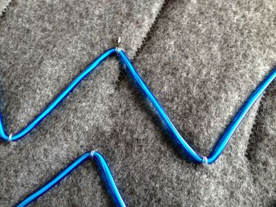

Step 7: Tire Track EL Wire
Before adding the EL wire, you may want to sew the squirrel body to the backing oval. This bit is pretty straightforward and I didn't take any pictures of it. You can see the stitching lines in the EL wire pictures though.
EL wire is a composite of a medium wire (20 gauge or so, it does vary some) with a phosphorus coating, a tiny outer wire in a very small gauge, and a clear plastic coating around the whole thing. You can make fairly sharp bends in it without a significant risk of damage. There are several useful instructables on dealing with it but here I will assume you have an EL wire, driver, and battery kit which is readily available in many places on and off the internet.
If you have a wire connector between the wire and the battery/driver, detach it as the weight of the driver makes it slightly annoying to work with. If it's soldered directly, though, you can manage OK. Starting with the driver/battery end, and at the part of the squirrel that will be down, pin and bend the EL wire into tire track shapes across the squirrel's back. You may need to make minor adjustments as you go along, or if your wire is too long or too short and ends in the middle of a treadmark!
Using regular, non-conductive thread in an inconspicuous color, sew 3 or 4 stitches over each corner of the EL wire shape. See the last pic for a closeup. I found a beading needle was good for this as it is really long. There is no need to make knots and cut the thread between each point; it is much more efficient to just carry the thread under the body material to the next stitching point.
